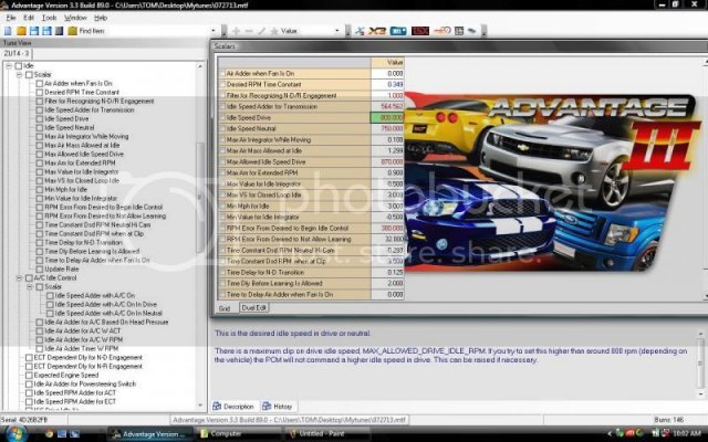

If you want to know the pcm logic for idle control here is some of the idle functions with a few tables opened in the software from my SCT advantage program. I can only open one table at a time so it would be tedious to show them all. This is my custom tune. parameters in red are larger than stock, blue lower, black stock.
You may think it would simply monitor rpm and adjust the IAC accordingly but unfortunately its not that simple.
Its my guess that its due to the lag time of the motor vs IAC opening or closing event. The motor simply does not respond quick enough to changes in the IAC for a simple feedback loop. So it "calculates" where the IAC should be based on the software. To confuse it even more the pcm also uses ignition timing to steady idle as the motor reacts quickly to changes there.
