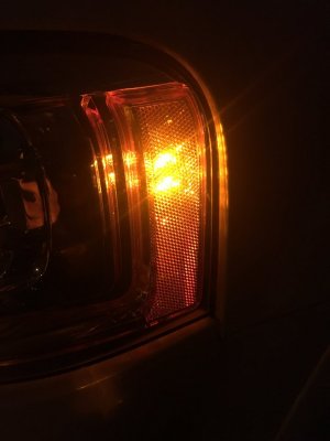

The ones on the outboard sides are already LEDs. Only the turn signal bulb closest to the grille is incandescent.View attachment 21860 can these be accessed and changed to LED? Little amber lights on far outside of the headlights. Just switched out the front turn signals to amber LED (went with JDM ASTARS for these) and was wondering about these little guys
Thanks!The ones on the outboard sides are already LEDs. Only the turn signal bulb closest to the grille is incandescent.
