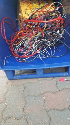

Wires I pulled out of the truck.

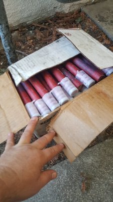

And of course, your friendly box of 10 minute flares. WHOHOO!

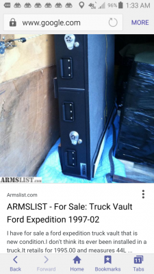

That box is for weapons storage. There are people that will pay big bucks for them. Depending on the size they can be quite expensive when new.
If it's something like this one, some dude on the internet (authoritative source innit?) claims they retail at.... $2k.
Did it come with keys?
If you go to www.truckvault.com the double layer version that LiverpoolFC has is worth about $3000.00 You probably get a discount from the site but they show it as value.
I configured one for a standard 17

Sadly. no keys... I looked around the truck as I was cleaning and found 1 key which appears to be for some other car, but nothing small enough to fit the lock.
Mine isn't the double layer. More like the one Adieu posted, minus the combination lock. Mine has lockable twist handles. Like a filing cabinet type of a lock. But not strong enough... as I was pulling it out, I pulled on the handles and the drawers opened, despite me having "closed" them. The latch is aluminium, quite soft. But, this is fantastic info! Even if I can get rid of it for 500 USD, i'm happy. It'll help finance the rest of the stuff I want to do to the car.

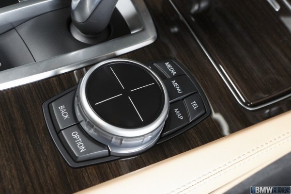

I am pricing out head units now, and I was looking for a controller similar to the BMW idrive rotating knob. You'd think there would be aftermarket units out there, especially with the whole line of Android head units available, but nothing that is made specifically for cars.

One thing I wanted to point out... There are several Android and other types of head units out there, all touch screen, yet little, very little in terms of controllers outside of the screen itself. Yes, some integrate with the steering wheel controllers, if there, but if not then it's limited choices.
I was looking into options and possibilities of some form of a console controller similar to the BMW idrive system. In case you don't know it, it's the below.... the knob rotates and clicks and also the other buttons are there too. That way you're not looking at where your fingers are but at the screen/road.
It seems someone in a BMW forum has been able to integrate this very controller.
http://www.e90post.com/forums/showthread.php?t=1405225

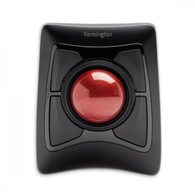

Given that my tech skills don't involve programming, I've settled for lesser options. One of them is a Kensington Trackball mouse. It should work since Android does support mice but whether it will serve my purposes that's yet TBD.
