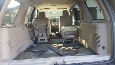

Following are the pictures I took yesterday as I was working on it.
Stickers removed with heat gun and patience.
Pulled both side panels to discover of wiring and equipment.

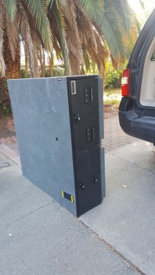

But before...had to pull this out of the back. It's huge heavy and I'm sure I will find a use for it somewhere in the garage.
Wires I pulled out of the truck.
And of course, your friendly box of 10 minute flares. WHOHOO!

That box is for weapons storage. There are people that will pay big bucks for them. Depending on the size they can be quite expensive when new.
If it's something like this one, some dude on the internet (authoritative source innit?) claims they retail at.... $2k.
Did it come with keys?
If you go to www.truckvault.com the double layer version that LiverpoolFC has is worth about $3000.00 You probably get a discount from the site but they show it as value.

They retail for a ton! I do search and rescue, we work closely with the sheriff's department and they have their trucks crammed full. I was looking for one of these when I bought mine, but I'd hate to take it out every time I wanted to carry people in the third row. I ended up with a 55 gallon tote from Home Depot to carry my SAR stuff. If you want to ship the radios I'll certainly take them off your hands! Heck, I'd take the pushbumper for the cost of shipping, too.

Sadly. no keys... I looked around the truck as I was cleaning and found 1 key which appears to be for some other car, but nothing small enough to fit the lock.
Mine isn't the double layer. More like the one Adieu posted, minus the combination lock. Mine has lockable twist handles. Like a filing cabinet type of a lock. But not strong enough... as I was pulling it out, I pulled on the handles and the drawers opened, despite me having "closed" them. The latch is aluminium, quite soft. But, this is fantastic info! Even if I can get rid of it for 500 USD, i'm happy. It'll help finance the rest of the stuff I want to do to the car.
