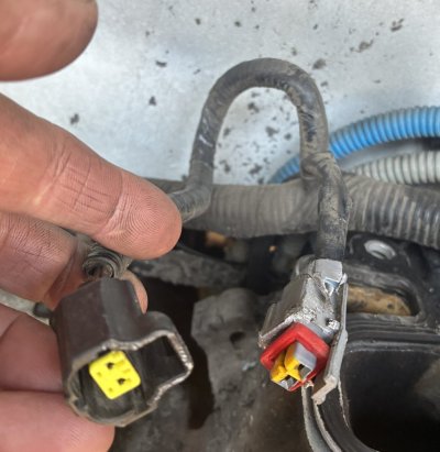

What Connector is this?
madbath2000
Jul 14, 2026
Washington
I was putting the intake manifold back on my 1999 5.4 2v, thought I had double check that everything was clear. I smashed the grey wiring harness. From what I can tell the black on plugs into the IAC. What does the grey one plug into and does anyone know the part number? Its by the firewall, drivers side.
AWAR
Oct 22, 2025
377
213
oregon
The injector wire plugs are gray, the one for cylinder #8 is separate and very far back on that side. Can you look and see what color the two wires are? I have been buying generic injector connectors for my Fords. Amazon has been fine. #8 has a red wire and a light blue wire.
AWAR
Oct 22, 2025
377
213
oregon
Look at the other injector connectors, then look on Amazon. The replacement ends will need to be soldered and shrunk for a proper repair. The replacement ends will probably be a different color. Did you verify the wire colors?
