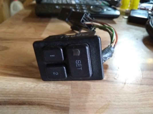

What is this switch called

This switch fell apart in the door and I had to take the panel off to get the parts. I glue it back together with super glue but I'm afraid it will fall apart again. Looked on Amazon but didn't know what it's called to search for one. IMG_20210616_133222012.jpg

97 03 Ford Expedition Navigator Memory Seat Control Switch F57B14776J4CPR OEM
