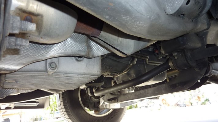

not sure why i've never notice it before and i did try to find it in the set of expy manuals i have... it's a metal case (2003 eddie bauer expy) right between the oil pan and the transmission pan... it has a plastic cap at the bottom... is there a name for this rascal? hard to look up something when you don't know what it's called!

I think you're just talking about the transmission bell housing ? It's the front part of the transmission, it houses the torque convert and flywheel.

yep... that's the thing... so... why the plastic plug... are you supposed to access it or something? it looks like 'something' has been leaking above that... the metal plate before that 'thingy' with the plug is greasy as is the bar below it... checked the transmission oil and it's fine and no spots on the driveway.. i have a cardboard box under it too, been there for months and no spots. so SOMETHING is leaking from the SOMETHING ELSE, and getting on the dohickey with the plug (sorry to be so technical)... thinking maybe blowing a bunch of carb cleaner up there to super clean it, then 'follow the money'... i'm a relative newbie to the car thing... but being a small girl has it's perks.. i don't have to jack it up, and i can get both hands in places you guys can't...

a-HA.... a torque convert drain plug... thing... i found it in the book in section 301... it says to remove the plastic cap, then drain it... drain it of what? what's in there? nothing is leaking out of it, but i like to know how that fits in with the rest... i've changed all the fluid in transmission, front and rear diff, transfer case, oil, coolant, brakes and power steering... but i haven't a clue if this is something i should be doing something with...

When you changed your transmission fluid you would've removed the drain plug in the torque converter to let the fluid drain out of it, as well as drained the pan, and changed the filter (if needed..) . If you see any fluid in that area, it's either motor oil from the engine's rear seal, or transmission fluid from the transmission's front seal. If it's not leaking enough to leave spots on your driveway I wouldn't worry about it.

Not to disagree, but, I replaced my transmission extension seal and dropped the transmission pan and fitted a new filter recently. In my 2003 eddie there is no torque converter drain plug. There is the plastic cover in the housing but i removed it, marked the teeth on the flex plate and fully rotated the torque converter twice using a screwdriver and there is no drain plug. It's not possible to fully change the transmission fluid in this model, you just have to dilute it with fresh fluid after removing the pan only.

Not all original torque converters can be drained. It depends on which one Ford installed.

but to get back to the original question, why would you WANT to drain the torque converter? assuming it would be to get all the stuff out when you're draining the transmission so there isn't any old stuff in it? i can get under the truck and do all this stuff on the ground without jacking anything up, but technically, would parking it on a hill facing up drain it into the transmission pan? (yeah yeah, i know parking on a hill, but TECHNICALLY speaking)

The torque converter holds a lot of fluid. Can't even get much fluid out with the transmission removed and tipping the converter around to drain out its center. So without a drain plug a fluid change only gets about half the fluid.
If the fluid is really old and dark and there's no converter drain plug it can be a good idea to drain, put the pan back on, fill with fluid and run it for a bit to circulate through the converter, then drain and fill again. Costs more but will have much less of the old fluid mixed in.

I have the same issue. Its most likely what I have a front main seal leak. Just keep an eye on the fuilds but you can drive it fine as is.

It's wild that some torque converters don't and some do have drain plugs.
One important thing to mention is that if you don't see a drain plug when you take the rubber cap off, that doesn't mean you don't have one. It may be hiding. Put a mark on the torque converter, then get a ratchet/breaker bar and spin your crank pulley bolt (clockwise), and you'll start seeing the torque converter spin with the engine, and watch for the drain bolt to appear.
