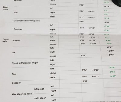

Thanks for your reply Andy!
Yea I got the paper but don't have it with me at the moment, I'll take picture of it and post it here.

I don't know if the second generation expeditions are like my first edition, but they sell an aftermarket kit that makes the camber adjustable. I installed both sides on mine in about 1 hour. My 2000 had the camber that was off, was why I I stalled mine. Unless you have torsion bars like my year I don't believe caster is adjustable. Unless your vehicle has been in an accident, your caster is probably fine. Most shops are about profit, which is why they set toe, and let it go.
USMCBuckWild
Oct 21, 2016
495
181
Camp LeJeune, NC
You CAN get it closer to perfect, but you are within spec. Just make sure tires are properly balanced and inflated to correct pressures and you will be good to go.
