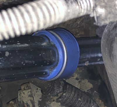

Did they put back on a Ford or aftermarket part? If aftermarket, that may explain the looser steering feel. I change a leaky worn rack on my 86 Mustang GT years back. Didn't like the looser feel of the aftermarket rack, but it was in, and I just lived with it. The OEM one had a nice firm feel, the aftermarket one felt like driving a 4 door sedan.

Blue thingy says FoMoCo
