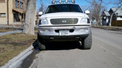

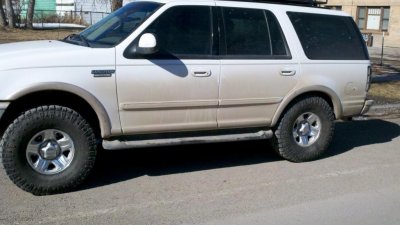

Well here they are. Tire shop said there was no problem mounting the 315's on my stock 7in rims. I cranked the torsion bars to get them on and now I guess I will rock the Cali Lean until I convert the rear air to springs and do the 3in aluminum spacers from ebay. But hey, 35's baby! lol
oh, and the guy I swapped my 285's with paid the $128 bill to have them mounted and balanced, PLUS gave me $100. So I couldnt really pass up the offer.

HOLY CRAP!!! i am so getting those for my next tires! now i know what they will look like. since i have those same rims... just black! i am getting those. how do they ride and handle? and are they E loaded?

Wow those are stuffed in there. I have 5 inches of lift, and I still rub when I'm backing out of the drive way. Are you having issues with that? If not, I'm sure everyone else on here is gonna be stuffing 35's on there X's in the next few weeks.
I'll have to bookmark this thread for all the newcomers who will be asking if 35's will fit stock setups. ( Other than the TT)

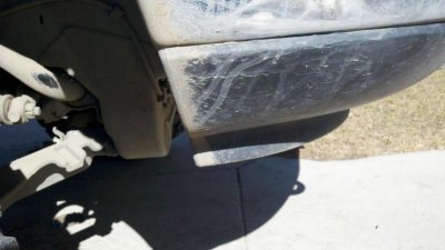

I wasnt too sure how bad I was going to rub the frame due to the positive offset of the factory rims. So to be safe, I pulled a couple of the wires that were attached to the frame on the drivers side off and secured them to the back side of the inner fender liner with a zip tie. I trimmed the bottom corners of the black plastic piece below the front bumper, but that was to be expected. Other than that, the tiny rub spot on the frame in the pic is all the rubbing I am getting. And thats at full crank. I am also including pics of the drivers side trimmed and the passenger side untrimmed for comparison. Hope this helps.

but damn those 35s look crammed.... I fell like my 37s are too small now..lol
