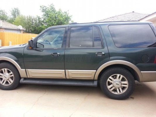

I have 18" F-150 wheels with that tire size on my 03 Expy.
You will not have any problems. Direct bolt-on.

Thanks for the picture.... Looks nice!
