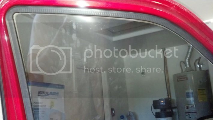

Hi all,
I have a 2003 expedition EB, and need to fix a couple of issues. the first is the driver side window. it stopped rolling all the way up and stops about half an inch before sealing with the window frame. what could be the cause of this? and how difficult would a self fix be? Also, the window sill moldings are fading pretty bad, and would like to either replace or repaint myself. does anybody have instructions on how to take them off? how much would new ones cost? i cant find any online, only chrome sill trim which i dont want. any help is appreciated, i have posted pics below to show the issues, thank you!

@ Auto Zone and Discount Advanced Auto Parts they acutally sale a rattle can thats specified for the trimmings...its like $6...and the window try removing the inside door panel and pull the seals off....try to readjust the seals and then try to close it...if still doesnt work right remove the window from the track...run the track up by hitting the window switch then back down replace the widow and see if itll work fine...if not it cant be much of a problem im sure its something thats not lineing up right....
