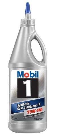

I would drain and inspect the rear differential fluid. Look for metal chips or shiny particles in the fluid. Sounds like your differential is coming apart. When's the last time you checked the fluid level ? There is a factory TSB bulletin out that says upgrade the fluid from 75w-90 to 75w-140 . If you "had" a limited slip differential ( Axle code H6 on driver's door tag...), make sure to add the LSD additive. But once it's making the whining noise and other noise you describe, it may be too late.
