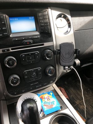

I did a wireless charging cradle so I can still see the phone.
Black
Mar 26, 2018
1,376
640
Kentucky
eBay or Amazon one of the two.
It has a vent clip on the back. I drilled a hole in a 2”x2” block, just smaller than the vent clip diameter, filled it with gorilla glue, stuck the clip in hole and let it dry. The 2x2 is just wedged in the cubby and stays put nicely.
Bought a 2 port USB adapter for the power port to plug in the wireless charger and still have an opening for a cable for the wife’s phone.
