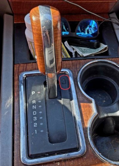

What rectangular piece are you talking about?
I circled it in Red for You. It Pops Out and then you have to Insert Your Ignition Key into the Opening and Shift to Neutral. Then You can Remove the Key and Start the Vehicle.
