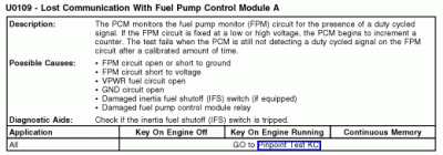

I had it scanned today and there was an error in the historical data.
U0109 Lost Communication with Fuel Pump Control Module (FPCM)
I have driven about 70 miles since it happened and have noticed no issues. Don't know if that set the wrench icon briefly or not, but had no other errors reported... Will keep watching, but so far, it was a weird 1 time occurrence.
deweysmith
Nov 8, 2017
574
206
Montreal, QC
I’m sure it did. Here’s the code description from ALLDATA.
Basically, the FPCM expects a modulated signal from the fuel pump to monitor expected fuel pressure, and it hadn’t gotten that signal for a few seconds, so it set the code. Once the signal resumed, the icon probably disappeared.
A short in the wire, corrosion on the wire harness, it could have been a number of things.
The FPCM is decently accessible, I think. Its connector is near the rear left wheel well, I’m not sure if it’s above the fuel tank or on the side. Personally, I wouldn’t worry about inspecting it. I don’t see this as a sign of impending failure or anything.
