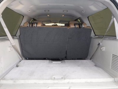

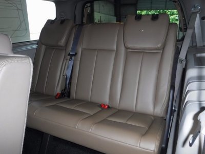

Fortunately, one fellow did the install and said it is actually very easy. Yes, the holes are there and yes, they are not tapped. BUT, Ford made the seat belt bolts to be SELF-TAPPING. I was very glad to hear this! It means you don't need to tap the holes in order to properly install the seats.
One thing to keep in mind: You must have ALL the parts and hardware to install the outboard shoulder belts. The way these install is different between "shorty" and EL models. I found an EL SSV truck for sale in Arkansas that obviously had a 3rd row seat installed after the fact because whoever did it installed the seat belts incorrectly. Don't be like this person!
Take a good look at the attached photos. Can you spot the problem? The shoulder belts are bolted to the "D" pillar. That's correct for a "shorty" Expedition. But, the EL models have the shoulder belts anchored much farther forward. The correct arrangement is also attached.

PS The area where the seat belt enters the lower quarter trim panel is a separate part that can be purchased new from Ford. So, there's no need to cut a "slot" in the existing panel. Doing that could possibly damage the seat belt anyway if you're not careful, so probably not a good idea. . .
