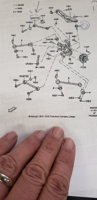

Keep the shop honest with a 2nd or 3rd opinion. Thats a lot of replacement with the given mileage.
They're being honest.
I live on a bad dirt road, have 3/2 spacers and drive 80+ miles 6 days a week. Plus our roads are garbage in Massachusetts
Luckily I purchased the extended warranty when I bought the car last year. They should pay for most of it.

What year is yours? My 07 doesnt have a "rear upper control arm" it has like 4 little ones plus the rear lower control arm. Its like a spider holding that shit on.

'14. The mechanic wasn't sure what they were. I work at the shop and I had to call the dealership to see what some of the parts are. Ended up being rear links and rear ball joints, but you can't order rear ball joints. I have to order the arm assemblies.
6,530
3,140
The CV axles on these don’t typically go bad if ever....if they are paying for it ok. If not I’d have a second opinion. Another thing, the control arms typically don’t go bad on these trucks either....they last 200-300,000 miles. Sounds like a lot of parts that don’t need replacing.

One mechanic at the shop says he thinks most of the repairs needed are because of the 3/2 spacers and another one thinks it's because of the age, mileage and where I live.

Based on your situation I think replacing it all is a good idea. You are running "long, hard and wet" as they say on something that wasnt designed to do it 24/7. Also if it is covered under warranty make damn sure they dont use economy replacements or you'll be back soon. Last there is no shame in switching to a front lift 1 1/2 only to level it. Im working with a company on making a 2/1 lift myself, partly for carport height, partly long life.

NEED is a relative word.
You never need all four inner and outer tie rod ends. Not all 4 will have play in them.
Same with upper and lower ball joints but shops are indoctrinated to do all at once or at least both uppers or both lowers.
Getting it safe is one thing. Not needing any repairs in 2 years is another...but need .....NOt quite.

I'd be interested to hear from anyone who has had spacers installed for over a year. Specifically how the drivetrain, steering and suspension components have held up.

3/2 isn't going to make a bit of difference to your suspension components.
Before I moved last year, I lived on a dirt road for the past four years. No real suspension problems in 215k miles.

Im about 5 minutes drive to the Sagamore Bridge :burnout:. I have the the 3/2 lift for three years now. I have to replace front dif seals, but i dont think thats related to the lift
