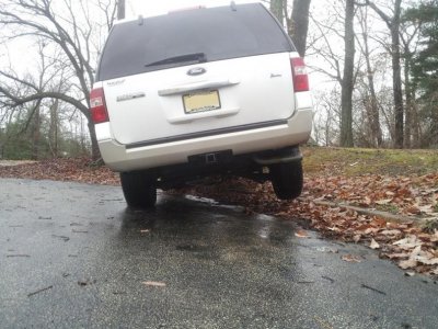

To make a long (and ongoing) story short, here are some pics…

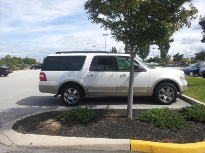

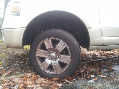

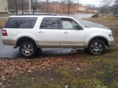

Before the lift.
attachment.php

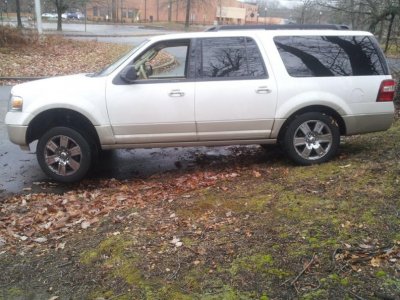

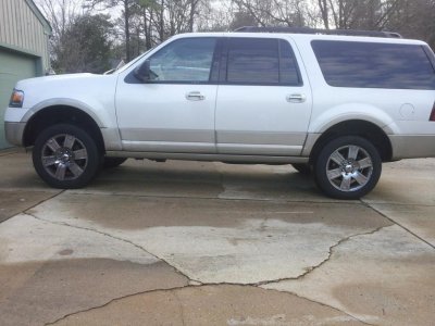

After the lift.
attachment.php

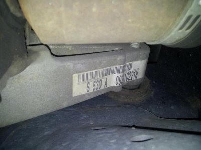

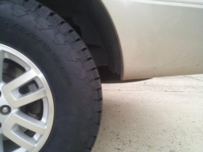

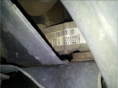

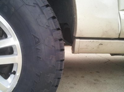

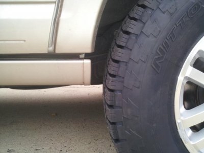

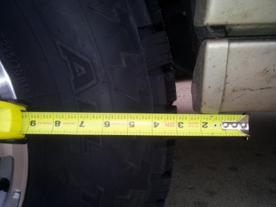

Taking some measurements for tire clearness, before buying tires.
attachment.php
attachment.php
attachment.php
attachment.php
attachment.php

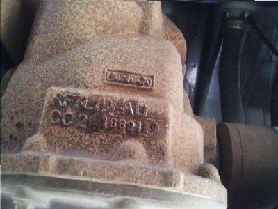

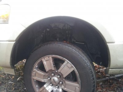

Not much articulation… for now..

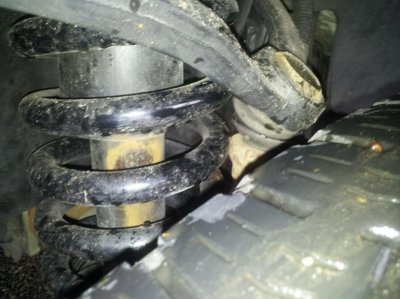

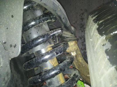

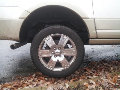

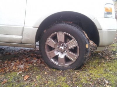

The upper “A” arm move down and get pushed hard to the spring. Although it is not much of concern if you don’t get off the pavement, it is definitely something to take under consideration if you do go/get into uneven terraine.
I can see why some manufacturers have concerns with the angles and powers the ball joints have to deal with, with that kind of kit.
If you want to do this right, you have to consider modifying the front upper “A” arms and/or ball joints and/or knuckles...
attachment.php
attachment.php
attachment.php

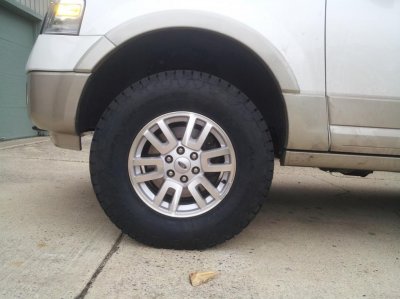

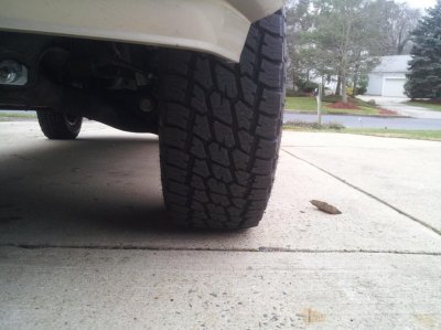

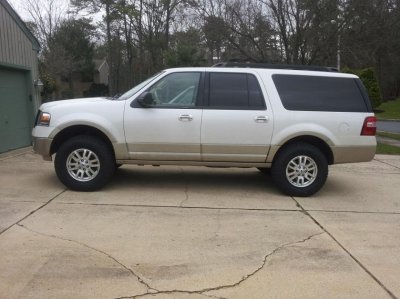

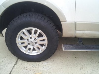

Nitto Terra Grappler AT LT295/70R18 installed.
No rubbing at all.
attachment.php
attachment.php

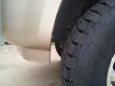

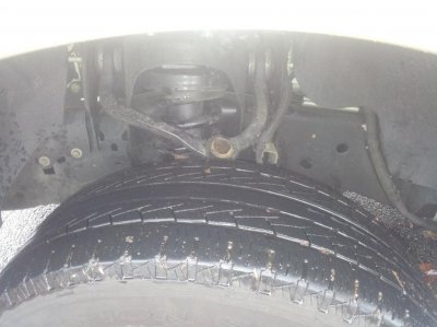

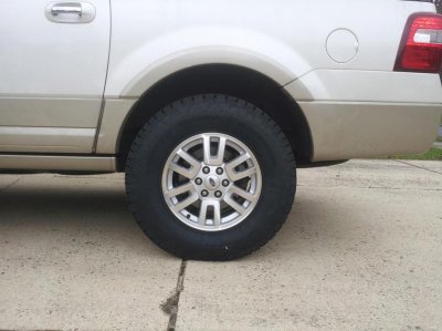

Front wheel clearness with 295/70/18.
attachment.php
attachment.php
attachment.php
attachment.php
attachment.php

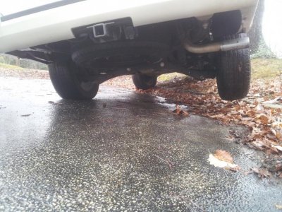

Rear wheel clearness with 295/70/18.
