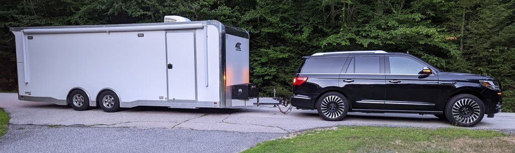

Bought a used thing. Aprox weight of trailer pictured is 8k lbs, car pulled back far as possible, vehicle fully oem, would not see significant other weight apart from driver and one passenger when hauling that trailer. Equalizer 1,000tw/10k hitch, not set super strong.
As a stock starting point absolutely is better than the 2016 navigator L i owned in past.
On table: 18" tires with higher load rating than the oem 22's, likely load e. Sumo spring coil inserts, moderately higher wd tension.
Also have been communicating with coil springs specialties about custom springs. Would be likely the best option.

I suggest visiting a scale. It does not appear you're moving enough of the rear axle load back to the front. If you're hauling a vehicle in the trailer you'll want to make sure your tongue load is in the 10 - 15% range. You'll probably want to mark the spot in the trailer that gets you there, so the tongue weight will be consistently within that range.

I agree and i'm fully aware of the 10-15%.
In this case the vehicle was as far back as its going to go (<1 ft to ramp door and at the end of the escape hatch for door opening). Zl1 1le camaro is nose heavy and long. Re the wd, i'm not tensioning it to megadick levels where things feel like they are going to break over contours and sharp turns. My 16' nav L needed that, it wasn't enjoyable.
Mounted some oem f150 goodyears i had around with a marginally higher load rating today, sumo coil spacers should be here this week will see if that and a bit more tension on the wd has a positive effect. If it doesn't custom springs it is.
