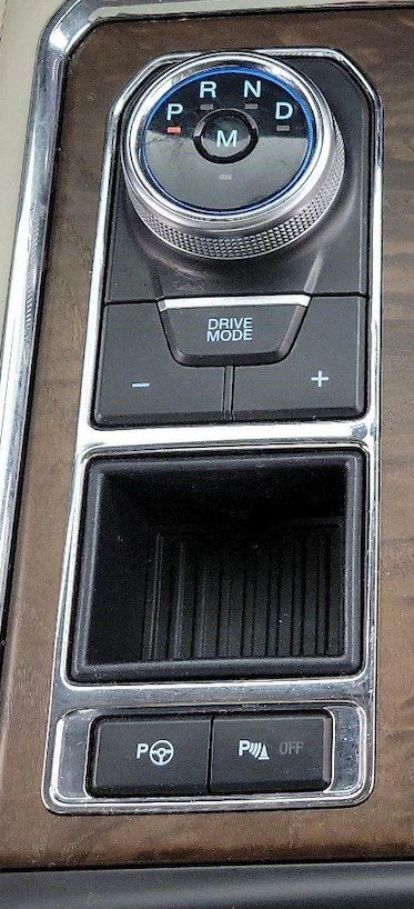

I have researched this as best as possible and have found no answer. I have a 2023 Platinum with the Heavy Duty Tow package. It shows on the door sticker that it has the “3L” axle. It took some research to confirm that stands for 3.73 Electronic Limitied slip (the 2023 Ford sight does not even show that as available).
So then I find that there is a button that allows you to toggle it on and off manually even though it also says it operates automatically. So I go to the online 2023 owners manual (there is no longer a printed full manual). Sure enough there is a chapter on the Electronic Limited Slip axle and it shows a button for manually turning it on and off. I have no such button. I have the full 15” screen eliminating almost all buttons - which I hate it. But the manual does not show if there is a place in the 15” screen to turn on/off the limited slip.
Anyone know what the deal is here?

I know my 2019 has the actual physical button and that was one feature I specifically wanted given getting stuck with these big SUVs is almost always a x up situation. Yes its a get unstuck button.
Having said that!! I recall reading somewhere that Ford changed the system in 21 or 22 likely tied to the driving mode selection and traction management making it a full integrated deal vs a manually activated thing. I know that they had cases where the old center console button was hit by stuff set on the console and people burned up the rear diff not realizing the locker was on. That’s likely why the physical button isn’t there today but the driving mode likely uses it when wheel spin is detected in say mud and ruts mode etc.

The ELSD is an option outside of the heavy duty tow package for the 22 and 23. You have to order both packages regardless of trim (62E is the ELSD). For earlier model years the ELSD was included with the tow package (and some other packages) but Ford changed that. If it isn't listed on your Monroney sticker you don't have it. I have a hard button near the gear shifter and mode selection for ELSD "lock" on my 22 with the smaller screen.
