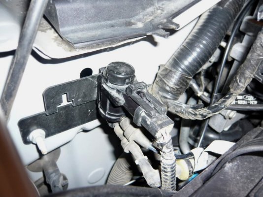

I have managed to disconnect my drivers side vacuum line for my 4wd actuator hub.. It is the skinny one and came disconnected somewhere over the shock tower. I can’t find the other end to reconnect. Does anyone know where the connection is located or from where it draws its vacuum?

The line runs over to the control solenoid on the firewall behind the battery. Maybe you can blow air (smoke) into the line over there and listen/look for it over on the driver's side to see if you can locate the end.
