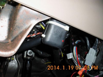

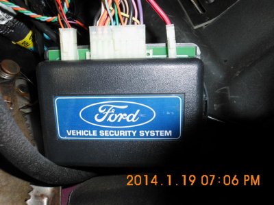

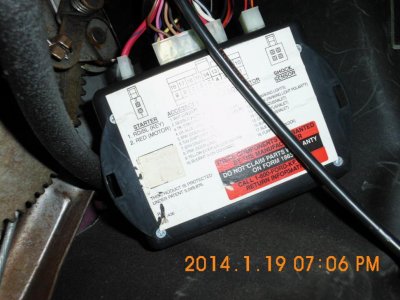

Here are a few pictures of the alarm system.
I do not have a separate key fob.
This "really" appears to be a factory item, even if dealer installed.
A couple of additional comments.
1. I have turned the white knob on the sensor and it had no affect. I don't know what the knob is for.
2. I disconnected the shock sensor from the main box, but that caused all sorts of problems. It would set off the alarm at random times, cause the alarm light to flash rapidly, etc...
3. Removing all wiring from the main box causes the Expy to not even try to start.
Any suggestions would be appreciated.
Thanks, Allan

One solution is to have a tuner disable the pats.
I would think that since there is a zip tie on the sensor case someone has been inside it in the past. You may want to open the case and post a pic of the board for us to look at. The white knob is the sensitivity adjustment. Since some of the other electronics over the years has suffered from cold solder joints I would look for that while the cover is off.
