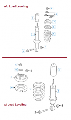

See that picture always confuses me. Is there a reservoir that hast to be mounted separately and then does tubing have to run from that reservoir to each shock? That the confusing part or is it all self-contained within the each shock?
All within the shock. The diagram is just for the visuals. There are outer and inner reservoirs within the shock body.

Has anyone actually gone thru with the conversion from standard non-load leveling shocks to the Nivomat shocks? What all was required? Changing springs, dust boot, mounts, etc? Results?

Second that question! I recently test drove a 2014 Limited that had the factory rear load-leveling option with 20-inch wheels and I can say it had a better ride quality than other similar trucks I've driven recently. I am thinking the rear load-leveling shocks may be responsible for the difference.
I checked with Tasca Parts and discovered the rear shocks and springs (along with some other parts) are all different between the standard setup and the load-leveling option.
