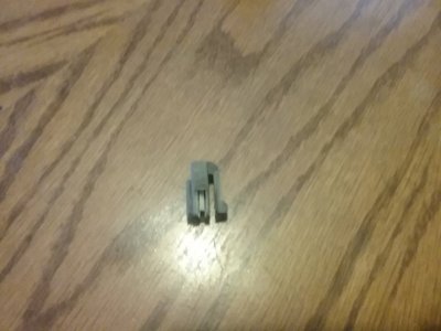

The problem was one thing with 2 problems, the single wire connector has a broken tab and there was green corrosion in the plug connector. Now if I was not in a hurry, I might have caught this when I first unplugged the first alternator.
I changed out the connector and cleaned the metal contacts, light has not come on since.
