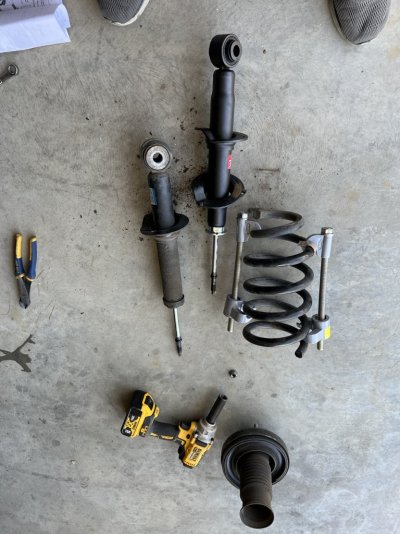

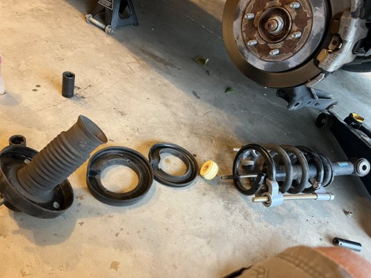

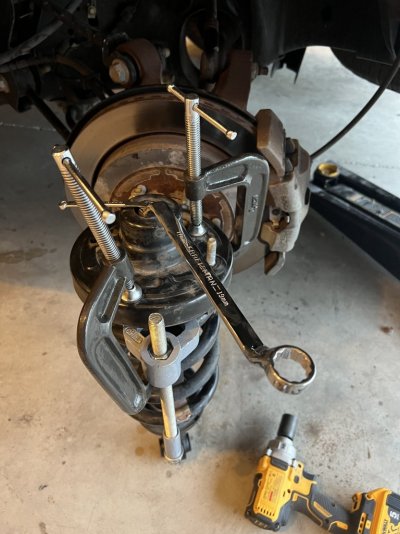

I have a 2015 limited, 2wd, 108k
Non load leveling.
I just did the rear shocks, and installed kyb excel g 340072. Helped the ride immensely. It’s not an easy job, but isn’t the hardest. A pre assembled shock / spring assembly would help speed things up.
For the rears, You need to remove the bottom bolt on the shock and the bottom bolt on the control arm to frame. You will need a deepwell 30mm impact socket and a regular depth 27mm impact socket. Then the upper three bolts holding the assembly to the upper frame. Upper bolts are 15mm (I recommend a ratchet wrench). Then wiggle it out. I reused all the parts off of the factory shock and reinstalled them on the new kyb shock.
Both rears took me 5 hours with no rush and getting interrupted with kids and stuff, and taking a couple breaks due to the heat.
In the one pic, I had to use c clamps to compress down the top mount to get the shock nut on.

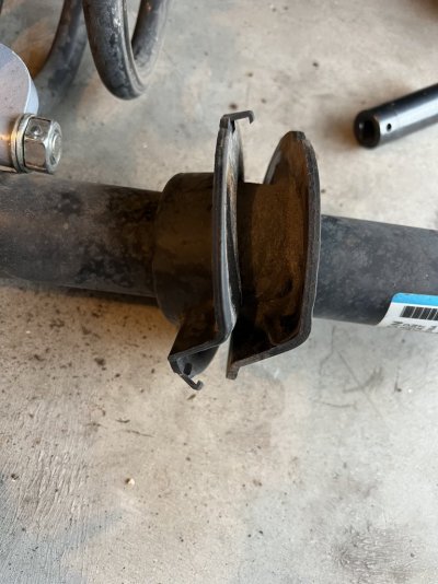

The factory struts have a removable lower spring plate. Keep it in case you ever decide to do the lifting struts. It gets thrown away a lot and isn't a stand alone part, gotta buy the assembly from Ford to get them.
