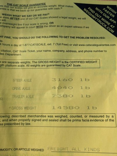

I did a bunch of homework on capacity leading into this trip, including the 3-weigh gold standard, plus a fully-loaded weigh on the return trip. Numbers:
Steer AxleDrive AxleTrailer AxleTruck WeightGross Weight
Truck Only28603000-58605860
Truck with Tongue Load27003720-64206420
Truck and Trailer, no people266039007240656013800
Truck and Trailer, full load316040407380720014580
Boat/Trailer Weight:13800-5860=7940
Couple thoughts here on the numbers:
1) The first three weighs all came within 10 minutes and all on the same scale. I don't understand how the steer and drive axle weights could be this different for the second two measurements. Truck with Tongue Load means the trailer was hooked up to my truck, but the trailer axles were not on the scale. Truck and Trailer was the same setup but with the trailer on the scale as well.
2) The Truck and Trailer, full load weight was taken on the drive back with the boat attached, all four people in the car, and all our gear.
3) Knowing I was going to be up against the limits, I installed a WDH for the trip - without this I would have probably exceeded my rear axle rating (4380#)

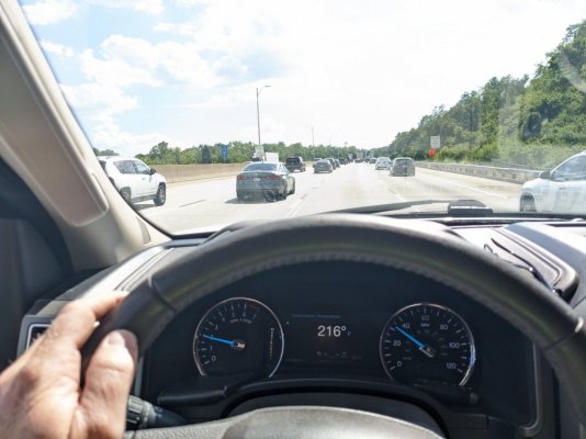

The drive home we averaged 13.6, and unfortunately had a more eventful drive. We came through Cincinnati around 4:00p and hit early rush hour traffic which had us doing 5-10mph by the GE factory which is a slight but long grade up (when going north). Out of nowhere, the "Electronic Limited Slip - Reduced Torque" message popped up on the driver info screen. I had my wife do some quick googling, but I figured it was heat related since the outside temp was also 88 degrees. Her search found this link:

So, we pulled off the freeway for a break and to give me a chance to search this forum to see who else has seen this issue. After reading the message above and knowing I had a 'full size spare' installed, I used an online calculator to compare the 275/55/20 outer diameter on the new Pirellis vs. the Wrangler "Full Size" spare, which is actually a 265/70/17 and found that the Wrangler was actually .3" smaller than the Pirellis. The ELSD warning never actuated on the trip down, so I'm not sure if this is enough out of spec to be the problem but it definitely wasn't helping. I think the combination of ambient temp, 14580# GCWR, and "undersized" spare all conspired to cause the message to pop up. While researching this forum over a milkshake from Big Boy, I developed a couple options:
1. Hurry up and wait. Do Nothing other than let it cool down.
2. Find a tire shop that has a 275/55/20 in stock and buy that (I'd have to find one that has the same OD as the Pirellis).
3. Rotate the right front Pirelli to the right rear, then move the Wrangler to the front. This would ensure that both rear tires were the same size, but would have required me to disconnect the trailer (to be able to safely jack the truck up), followed by a tire juggling act (using the "flat" Pirelli) to rotate the tires, then having to reconnect the trailer/WDH setup. This seemed like the best option, but I was dreading the fiasco this was about to become when I came up with the best idea:
4. Deflate the left rear Pirelli by about 10psi to reduce the OD a bit and get it closer to the Wrangler.
Between #4, the 45 minute break, and slowing down to about 62mph, the ELSD warning never popped back up and the rest of the trip home was uneventful. I'm not going to lie, I was thinking that its time to switch to an F250, but the Expy is mostly driven by my wife and I just can't see her enjoying a real "Truck" as much as she likes the Expy.
