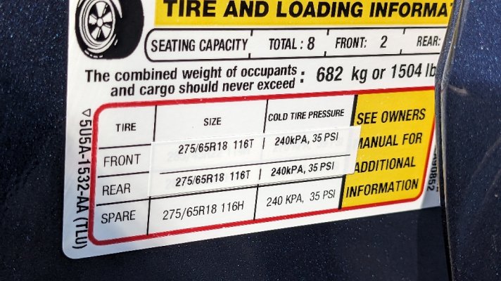

Yes like others said do not set the pressure outside of what is on the door sticker for normal driving.
If you have 20"s or 22"s and live where the roads are not that great, going to an 18" will give you a much nicer rider.
This is why all the Trophy Trucks and off road vehicles go with 17"s. For terrain absorbing and sidewall protection.
