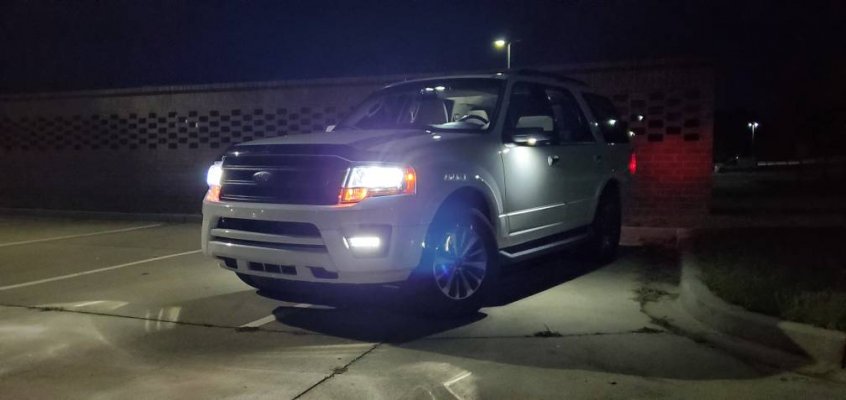

Thanks everyone for all the comments it was suprising easy for once. I just did the low beams they match perfectly with the fog lights.8e1565eb388216734da7dce12f27db4a.jpg

Looks good! Which bulbs did you go with? They appear to be a perfect match. I have a set of the philips crystalvision bulbs waiting to go in, but I'm not sure how close they will match the fogs.

Sorry for the late response these are SeaLight LEDs X1 series.

I have the same ones. they have been going strong for about 6 months now, no issues at all.
I also used their high beam bulbs...fit was a bit tight but they do work in the factory housing.
