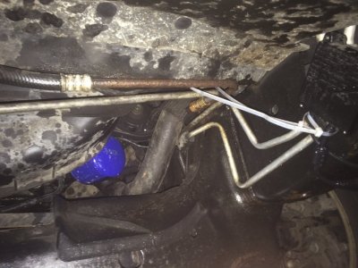

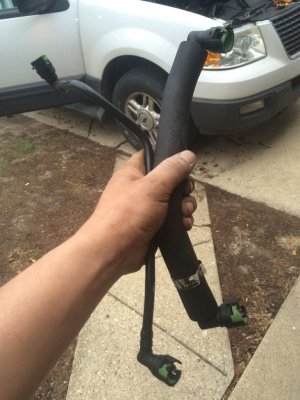

Here's where I'm at now
Also I noticed that there's a puddle of transmission fluid under the radiator support, possibly coming from the pressure fittings on the transmission line? It pretty much looks like it sprayed all over with force cause oil is everywhere, there's no leaks at the transmission or near it itself just where I noticed it.
Edit: ok I just took it out for a test drive & it pulls hard on first gear without bogging out, actually for the first time since the motor swap it pulls that hard and holds the 1st gear all the way up to 3250rpm without a struggle.
I didn't faint, hesitate, stutter or shake indicating it wants to shut off while stopped or aproaching a stop while in gear....yet, tomorrow I'll get the real results to and back from work.
I did everything 99whiteC5coupe suggested plus I changed the VCT's and added a quart of oil (seemed low about 1 quart). I still have to track down the mysterious trans fluid sudden leak but hopefully the problem with stalling is corrected.
I'll keep on the look out for any other suggestions and advice, until then I'll keep you guys posted.

When the engine is up to temp and running the ecm enters closed loop operation. At this point it crunches the numbers based on input from all of the sensors. A sensor can be bad but still provide data that is within spec - it just isn't accurate.
I would verify fuel pressure is within spec then move on to the sensor data and finally check egr operation.
You should find and fix the trans fluid leak. If you don't it could get expensive quickly.
