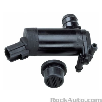

If you're not getting 12v at the washer pump I'd suspect the stalk switch. But don't be surprised if the washer pump IS bad, it's not uncommon. Fairly cheap to replace. I only point to the stalk switch because the high beams are dead as well.

Washer pump.... same pump does the front and rear ....
