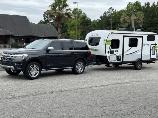

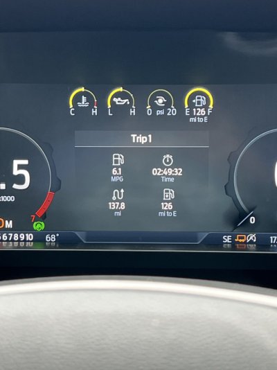

I am currently getting SIX MPG!!! Towing a 3,000lb travel trailer averaging 68-70mph. I am astonished. My 18 f-150 with the 3.5 had a 36 gallon tank and would get 9mpg towing the same trailer with a WAY bigger range. I am hoping the motor still isn’t broke in and will get better over time. This is crazy. Full tank only gets me 126 miles. This road trips gonna take for ever. Is this correct or is something wrong?

Did you go both directions? Trailer aero has the largest impact on towing. Your poor mpg could be caused by a combination of a grade and headwind. Also lockout the top few gears. If the engine is using boost to maintain speed, which it likely is at 70 mph with a camper, it's going to run rich. Using lower gears will reduce engine load and boost. Try different gears to see how mpg is impacted. Use the tow haul setting as well.

The weight of the trailer isn't making much difference for the MPG, it's the flat air-dam front plowing through the air like a huge air dam.

I had the same lift and tires on the f-150 with the same engine.. and the trailer had nothing but our clothes in it, the expedition had nothing but me my wife and two year old so wasn’t over any weight limits. Only thing I can think of is that I haven’t recalibrated the speedo for the tires yet, but that still wouldn’t affect the mpg as drastically as I’ve been getting. Slowed down to 65 and was seeing 7-7.5. Once we hit the mountains coming into gatlinburg it was 5-5.5 LOL. I wouldn’t care about the mpgs as much if it had a bigger tank.
