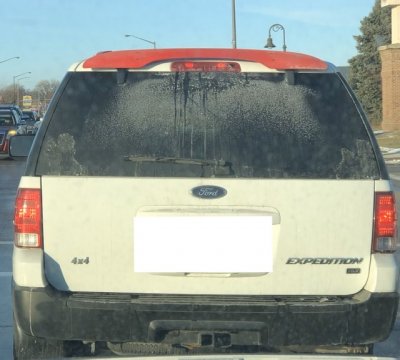

Thanks Lakeside, I did not even think about the Navigator. So they may be available in a parts catalog somewhere. I will investigate this. Probably easier than getting EAndy and powerboatr to develop one...:angels25: Yes, stay tuned, something is out there that will work.

A company called Sorana makes a product that has a slot in the middle. Product number is LC-003-RW. The few websites that list these explain each are made to order, so can take a few weeks.
Shown on a 03-06 Navigator, but no logical reason it wouldn't fit any Gen 3 Expedition/Navigator.
I'm skeptical that these work for what you want it to do. Applying a regular a coat of rain-x on the glass probably your best bet as glass is porous. You can buy a lot of Rain-x for what these places want for a few hours of (unpainted) fiberglass work.
Thanks Flex, but this airfoil will only bring air flow upward from the wheelbase. I am looking for something that blows downward to clear the vacuum along the rear window.

I found this on eBay for a 2002-2004 Navigator, but have no idea how it would be configured. Most of these are marketed to look cool and enhance certain areas of lacking manhood. If it actually blew roof air downward, I would consider it, but no info on the eBay site.
