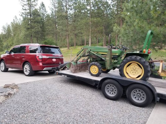

While moving my tractor around this past weekend, I moved the vehicle multiple times with the door opened. Here's what I experienced:
When my seatbelt was on, vehicle was in drive or reverse, and I opened the door - lights and bells started going off but it stayed in gear while at a standstill.
When the seatbelt was off, the vehicle would shift to park automatically - HOWEVER, it was extremely easy to just shift it back into gear while the door was still open. I DID have to press the brake pedal to get it to shift out of park when the door was open and seatbelt was off.
Either way, based on the flashing lights and bells, the vehicle is very concerned about safety when one tries to move the vehicle with a door open.
A curious thing to point out - my 2019 Expedition didn't do anything other than warning bell and light if one of the passengers unbuckled and opened a door while the vehicle was in gear at a standstill.
