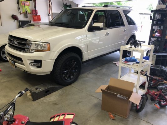

Your Expedition looks great! How's the ride quality with the 33's? I was at Discount Tire yesterday, and the sales guy said the 33's don't ride well...suggested 275/60R20 for the stock wheels. Any feedback?
For off road 35s on 17s ride great along with 33s on 17s. Tire psi around 45.
On road if you have an AT tire or Hybrid or mild Mud like Nitto Trail Grabber you will be very happy as they still ride great on the road. (Wheels a 17 or 18” max)
20s are not the best off road wheel. Not enough rubber on the 20” tires.
Of course you didn’t mention if you want off road set up or on road only????
