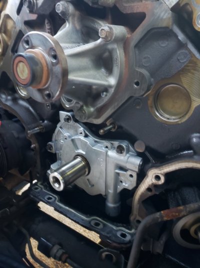

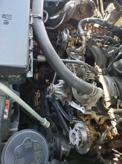

I have done the following maintenance / repairs (the miss has never improved or gotten worse during any of this)
New OE plugs from ford (no fakes lol)
MSD street fighter coils
Changed all fluids (engine oil, power steering, transmission, rear axle, coolant and brakes)
Full Timing set with ford parts
M360hv oil pump
New thermostat, radiator cap and water pump
I run penzoil 5w30 ultra
New battery
Any ideas? Not sure where to look next, possibly injectors? I took it to a local shop, they could feel what i was talking about but couldnt find anything wrong.

I checked all the followers, nothing loose or jacked up looking. I did the timing job without pulling any. Engine idles super quiet but a little rough sometimes, all i can hear is the injectors.
