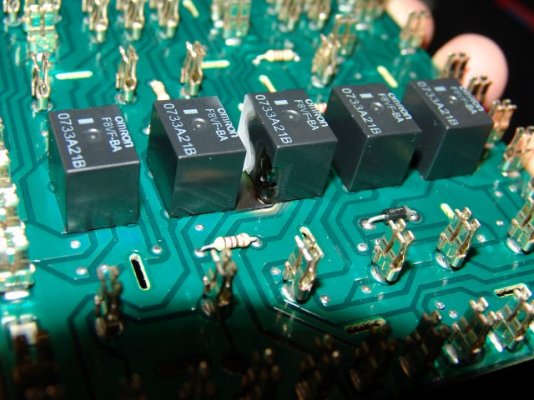

Hi to all, just happened again 6 month later, I just read again an is a bad fuel pump relay, just swap the PCM relay by the fog light relay and start up again, I notice the middle contact of the PCM relay is little melted, if anyone can send my a link how to repair the fuse box going to be appreciate, want to give a try prior to spent $$$$ in a new fuse box.
Thanks guys!
