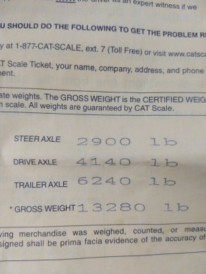

I pull a 7000lb (wet), 31 ft trailer with my 2017 Expedition using WDH. Plenty of power for hills and such. Gets a bit squirrely in the wind, but this could be tires too. I usually drive between 55 and 65 depending on wind. Any higher than 65 and fuel economy plummets. I get between 8 and 10 mpg at these speeds. The payload limits the vehicle to this trailer weight, as there is only ~1650 of payload before the travel trailer gets hitched, and the hitch weight consumes most of it. The 9K+ tow is a pipe dream if you have any passengers or a high cd. Maybe if it's a load of bricks you could get near it, but not with a long travel trailer.

Here are the numbers from my last trip to the scale. I have since added more weight on the front axle, but I think the numbers were close to where they needed to be. I may stop at the scale again since we're towing this weekend.IMG_20190613_182947972.jpg
