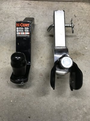

I have a Weigh Safe 2-Ball Mount w/ Built-In Scale - 2-1/2" Hitch - 4" Drop, 5" Rise - 14.5K
I dropped it a couple inches and never needed the lowest setting. A pic is attached with my 18' Featherlite. I had to slightly change the weight distribution by moving the car slightly forward and dropped the height a tad more after the pic but this should give you an idea. It's not even close to the lowest setting.
