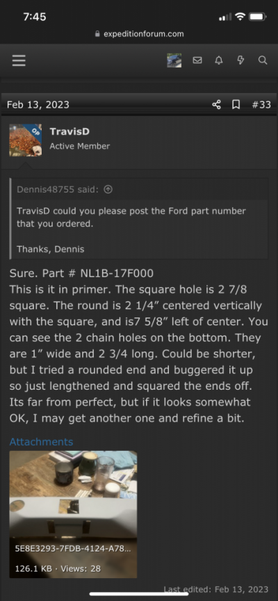

Want to purchase a second cover and cut the center out so it will fit in place when I have my tow ball mount in place.

I was going to do this too but then realized I needed holes for the plugs to and the hole was getting big. I still think about doing it for my bike rack that is on most of the summer but haven't bothered with it yet and have gotten so used to it not being on I don't know what to think.

I think what makes the hole so ugly is the ‘holes’ and ridge that the cover clips into. Perhaps painting them with a flat black paint may make the missing cover less obvious?
