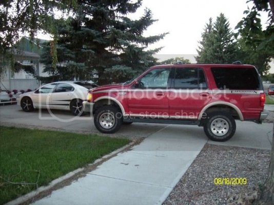

That is quite a rake.... But I think mine looked about the same before I did the body lift. My rear springs were not as stiff as yours though, so not quite as much height in the rear.
For comparison.. this is how mine looked after I did the TT and rear spacers...
