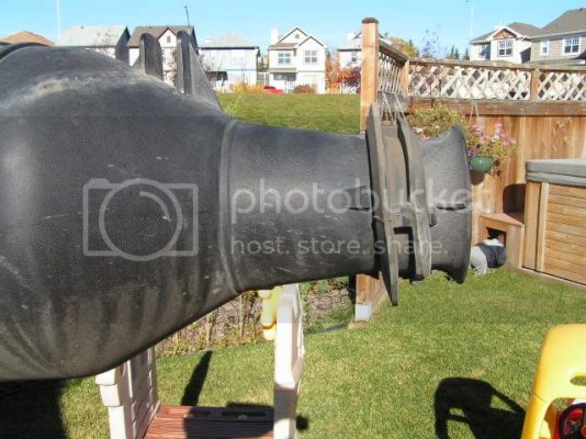

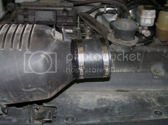

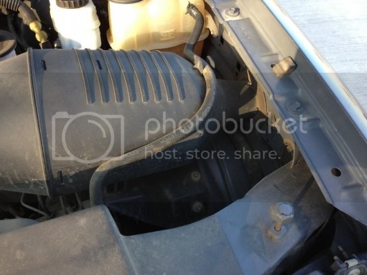

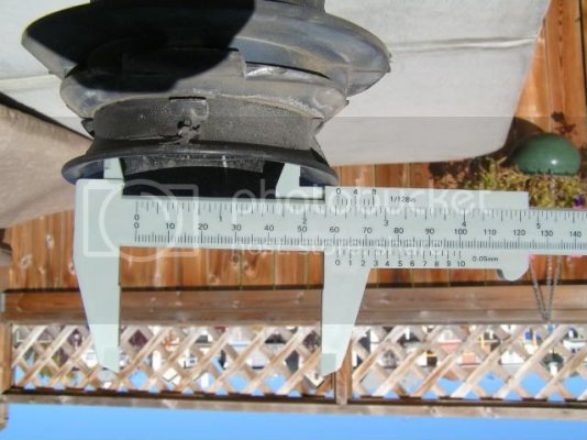

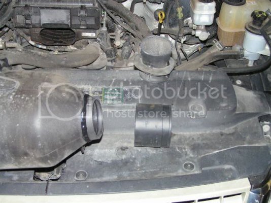

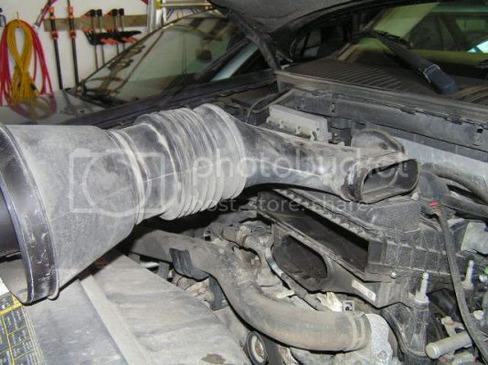

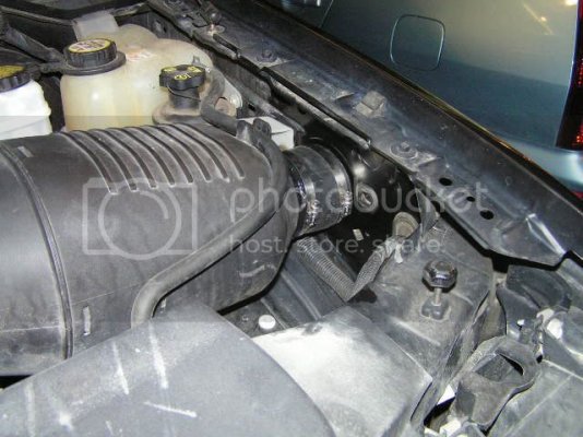

So I just measured my 2006 up for the Gott's Mod here is what I have found out with photos. On the 2006 it's a single piece and you will probably have to hack it up a bit... that said the photo's speak for themselves - 2 3/8" unobstructed in mine - the calipers on the opening do not lie.
Has anyone in here done this already to a 2006? or other similar year with the same set up - I might have to be the first - however there is no going back after I take a saw to the end of this intake...
