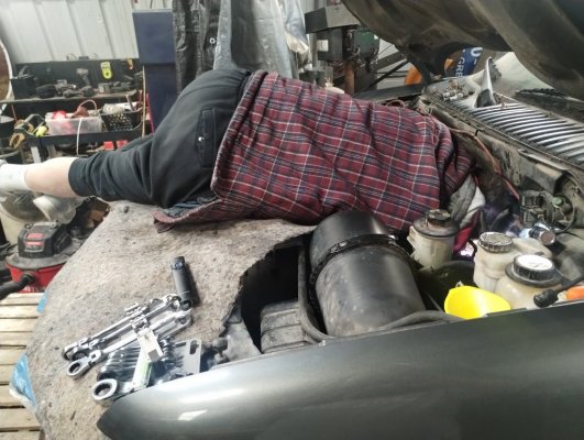

Replaced the tube today. Ratchet wrench is the key. 10mm and 13mm for those that are curious. Bought the fel pro orings for the tube. Got it all back together about 7 tonight. Started and let it run. No leaks. My dad volunteered to help for something to do. Good times on the studs
