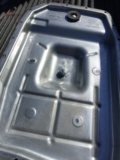

Thanks guys .. I pulled the pan off today whilst still waiting for the new filter to arrive .. I was pretty amazed
It’s dark but still had a tinge of red whilst draining .. the magnet had hardly anything on it ..
until this point I was going to do just the filter and pan oil ..
any more thoughts

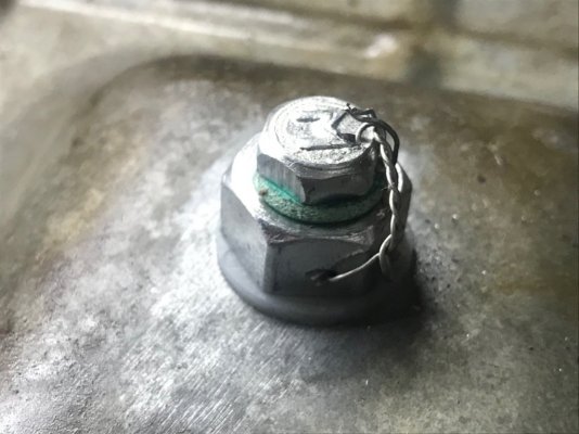

SO the filter arrived and i reassembled the pan with the bolts on at the back with it tipped forward to allow me some room to pump some fluid in, i got about 2 qts in and did everything up and pumped more into the fill opening.
I Had drained about 5 quarts out but ended up putting in about 7 so it was low .. Its a real pain to check but after 5 or 6 attempts id figured out how to hold it and get it out quick to check it.
I was a little concerned about the drain plug so i replaced the rubber o ring seal for a gasket material one and lock wired the nut too.
