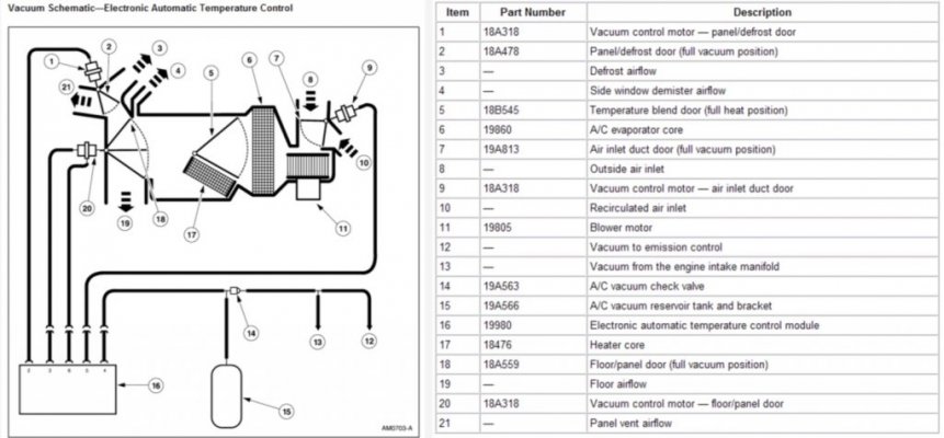

I a have a 2001 Expy with the basic AC controls including rear AC and controls. I am looking for both a physical and schematic representation of all the freon lines. Having part numbers would be nice as well. I am looking to have the system majorly serviced including dryer, orfice tube(s), expansion valves, hoses. Maybe the condensor coil as well. I dont want the shop overlooking some small component.

That is pretty helpful. But actually looking for similar for the plumbing of the Freon system. Would you happen to have that as well? For the dual, front/rear system.

Thanks that gets me closer. I have rear air as well so there is another evaporator core and, I wonder where the expansion valve/orfice tube fits into this. I am planning to repaint and also change the radiator support so per some shops, the condensor coil must be removed,. It would be good time to refresh the leaky hoses, etc.
