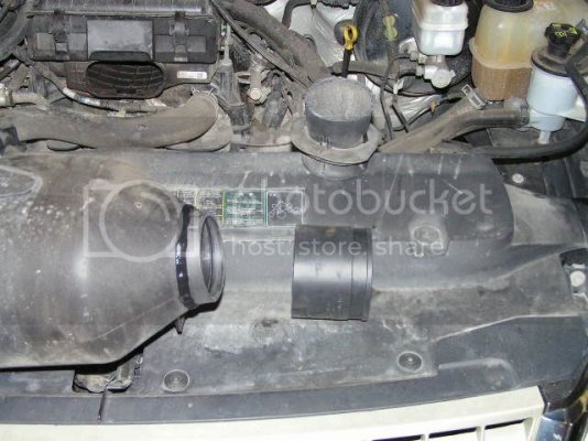

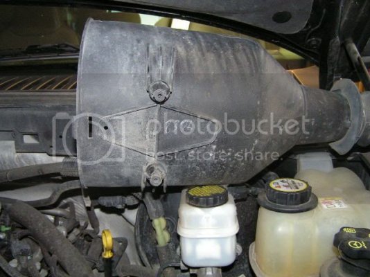

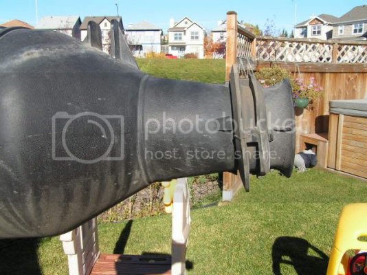

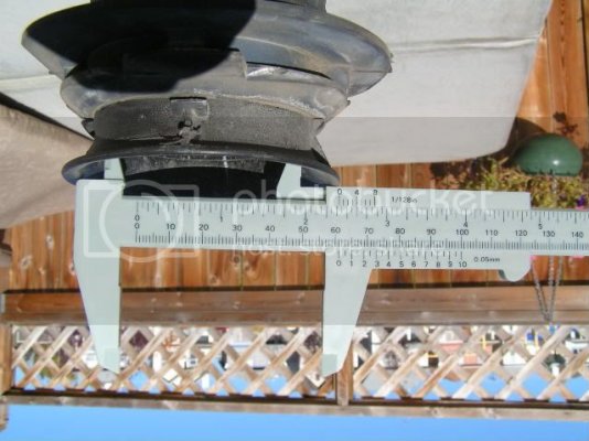

So I just measured my 2006 up for the Gott's Mod here is what I have found out with photos. On the 2006 it's a single piece and you will probably have to hack it up a bit... that said the photo's speak for themselves - 2 3/8" unobstructed in mine - the calipers on the opening do not lie.
Has anyone in here done this already to a 2006? or other similar year with the same set up - I might have to be the first - however there is no going back after I take a saw to the end of this intake...

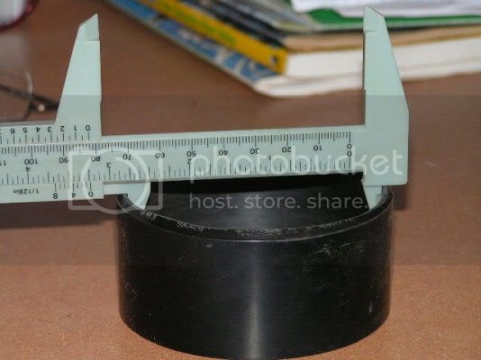

3 1/4" of breathing room... this is a PVC to ABS adapter so it's a little thinner than the standard 3" ABS - it's also easier to make fit into that not quiet round hole in the fender well - I still did a little sanding with a "dremmel" tool to the interior and exterior to smooth everything out

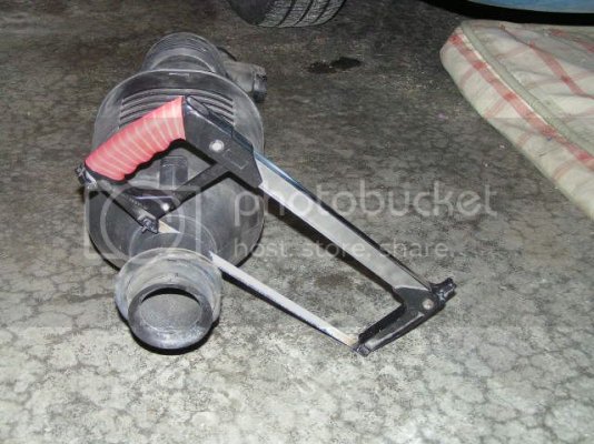

I'm committed now! Off with your head! :) (b)
Photos of the intake, rubber adapter, and part I cut off

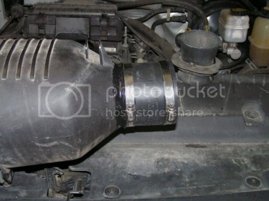

Rubber adapter with a little black silicone to seal the exterior - not on the inside so it should not ever get sucked inside - gotta love Permatex
Finished - completed all installed - now I gotta test it.
So from my calculations
2.4"+/- from the previous photos = 4.52 in2
3.25"+/- from the new Gotts Mod = 8.25 in2
That's almost twice as much area to breathe - so hopefully I'll see some improvements in mileage, power - I'll report tomorrow after some test driving
