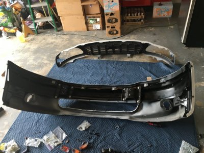

My new bumper has arrived and the bumper cover is on its way. I need to purchase new brackets for the bumper and need to know if the brackets in the very back of your pic are needed and where they go. Can you help me out?
Here you can see all of the parts needed for the Lightning bumper cover - Since I'm starting with a 98 I needed a 99+ grill shell, behind it you can see the Lightning bumper cover (just the cover) and behind that, a 99-03 F-150 / Expedition steel bumper. I painted the steel bumper with black VHT epoxy paint to try and keep it from getting rusty or pitted down the road. Behind the bumper itself, towards the right, you can see the brackets and supports that bolt onto the steel bumper to give it the shape to support the lightning bumper cover.
Here's a detailed look at what goes behind the Lightning bumper cover
I'm not sure exactly which bracket you're referring to, you do need all of them. The things in the very back on the right are trim pieces that fill between the grill and bumper, without those you have a pretty ugly gap. I think the 98 ones were not compatible with the 99 grill shell IIRC.
These are detailed instructions with pictures from when Ford used to sell the Lightning bumper as a kit from Ford Racing:
http://performanceparts.ford.com/download/instructionsheets/fordinstshtm-17957-l54.pdf
You can find all the parts here, you need the two braces and the 4 parts called "reinformcements" as well. Upper and lower on each side.
