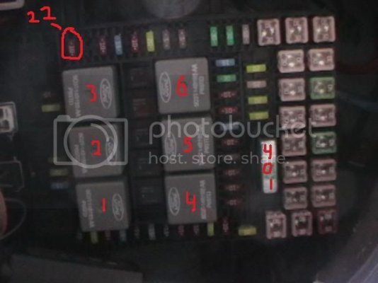

Ok so I checked fuse and it was good but I had to remove the relay above it to get fuse out. So I put it back in as well as the relay tried it just for kicks and it started. Unfortunately my windows, stereo and moon roof still dont work. So the non-starting issue is at least out of the way.

I didn't swap it. All I did is remove it and put it back in. I did swap breaker 401 after it started hoping that was the problem with the windows and radio but no luck there. The r02 relay is the one you believe that's the problem for the windows? I have no #4 relay in my truck to swap so I will have to do it with #5.

Well, it could be relay 2, or fuse 22 since both of those have have windows, moon roof, and radio as common objects.
BTW, just noticed your manual is different than mine, so the info on fuses is on a different page. Page 292 has the locations, page 295 lists fuse 22, and page 298 has the start of list of relays. Which brings me to my next question: If you don't have a #4 relay, that means you don't have rear defrost?

I do have defrost, I forget what my mannual says relay #4 is for and fuse 22 is the one that I checked when I removed the relay and put it back in and it started. I also swapped out breaker 401 I believe it was and still no windows.

You were right I do have relay 4 its relay 2 that my truck doesnt have. Just checked fuse #2 and thats good.
