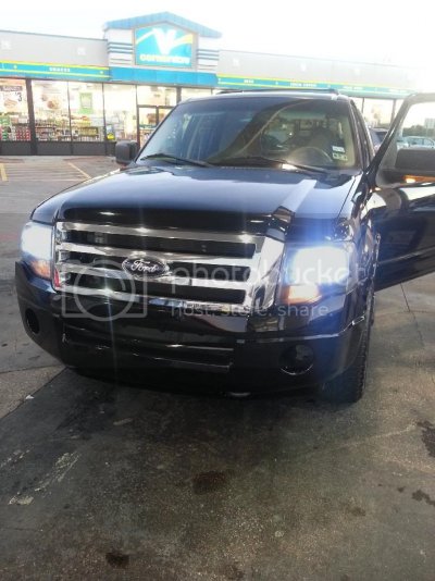

I just did this swap on a eb.installed the l.e bumper idk if im goint to buy 07 trim or modify the one I have buti need help from op.what number bulbs did you buy I used stock 07+ way too dim.any way i would love to know what mods u did to latch the hood down and how your brackets look for grill n lights im no welder but learning.
On another note installing bumper grill and hood are simple but alot of cutting to get the lights to sit the way they should

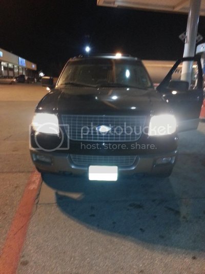

I have made some brackets to hold the grill firm in place as well as the lights just need to get the hood to sit rite.it off a little.i picked a kit up from oriely auto to convert the lights in the 03 to 9008 h13 bulb so all is good now just need to mod the e.b trim will post pics when complete

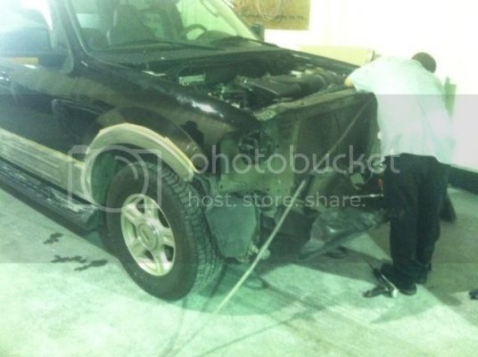

on the latch bro i had the latch made longer at wrk but after i got into looking at it real good i came find out that u can move up the peace that holds the latch up by drilling one hole on each side move it up until it latches. to align ur hood i had some longer bolts the ones that sit on u'r fenders tours the end of the front of hood, longer to where u can adjust the hood to line up with the fenders. on brackets i took them off and bought the radiator sopport for $180 way better...

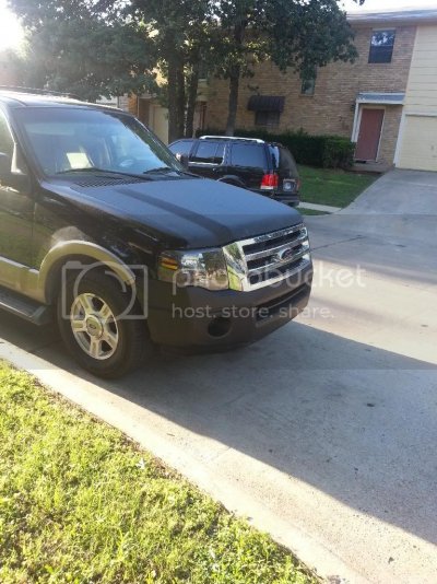

This was the outcome.in the end I welded the header pannel from 3rd gen to make it right..about 1500 in cost in parts n paint..not bad for my expedition. I painted the e.b brown to stock tux black looks nice.im still working on getting the front bumper cladding molded w.i.p but happy

Any body have questions message me will try best to awnser.once I had the upper radiator support all fell into place.big thanks to Cadillac the original maker of this thread had I not seen this I never would of jumped in to do this mod.extremly happy w the turnout.

Well all really just falls right into place.

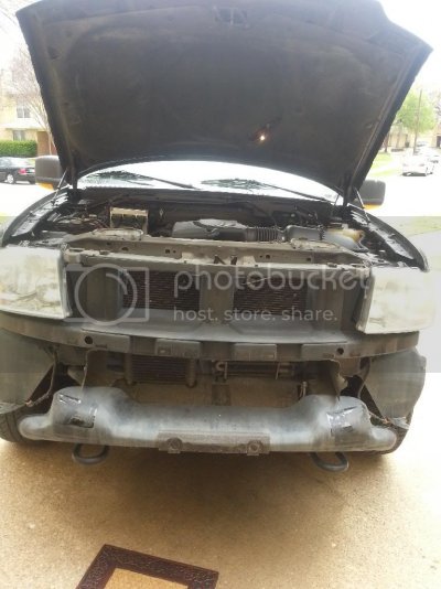

Need the upper radiator support- holds lights grille and hoodlatch
Bumper upper/lower
Headlights
Headlight bulbs neet o be retrofit.i just installed h.i d.s easier
And the hood
Its simpler if its not the limited/eddie Bauer editions no cladding to deal with
Once I had the hood on I just lined up the upper radiator support and welded it on.thats the hardest part if its
Off everything will be out of line.if you can find the bumper n hood in the same color thats the way to go..ill see if I have more pics.breakdown is pretty easy.
