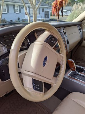

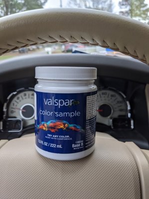

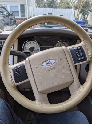

Touched up my steering wheel and passenger air bag cover. Used Valspar color called Mink Stole CI59. Matched really well. Just Valspar interior satin latex paint sample I got from Lowes. Cost about $3.50
wow, steering wheel looks great.. is that a spray or did you brush it on?

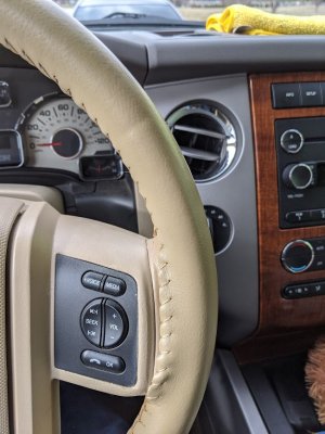

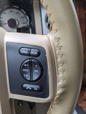

Here's the paint I used. Just go with thin coats and build it up. And a before and after steering wheel shot. The steering wheel was kinda rough and required sanding and reshaping.IMG_20200226_163712.jpg IMG_20200226_163716.jpg IMG_20200228_140939.jpg Steering Wheel.jpg

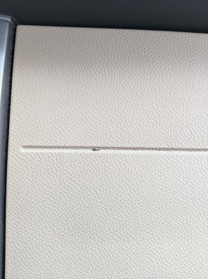

Here is a pic of the repair on the passenger side air bag cover. Color difference is just time of day. I only painted the indention on the cover.
